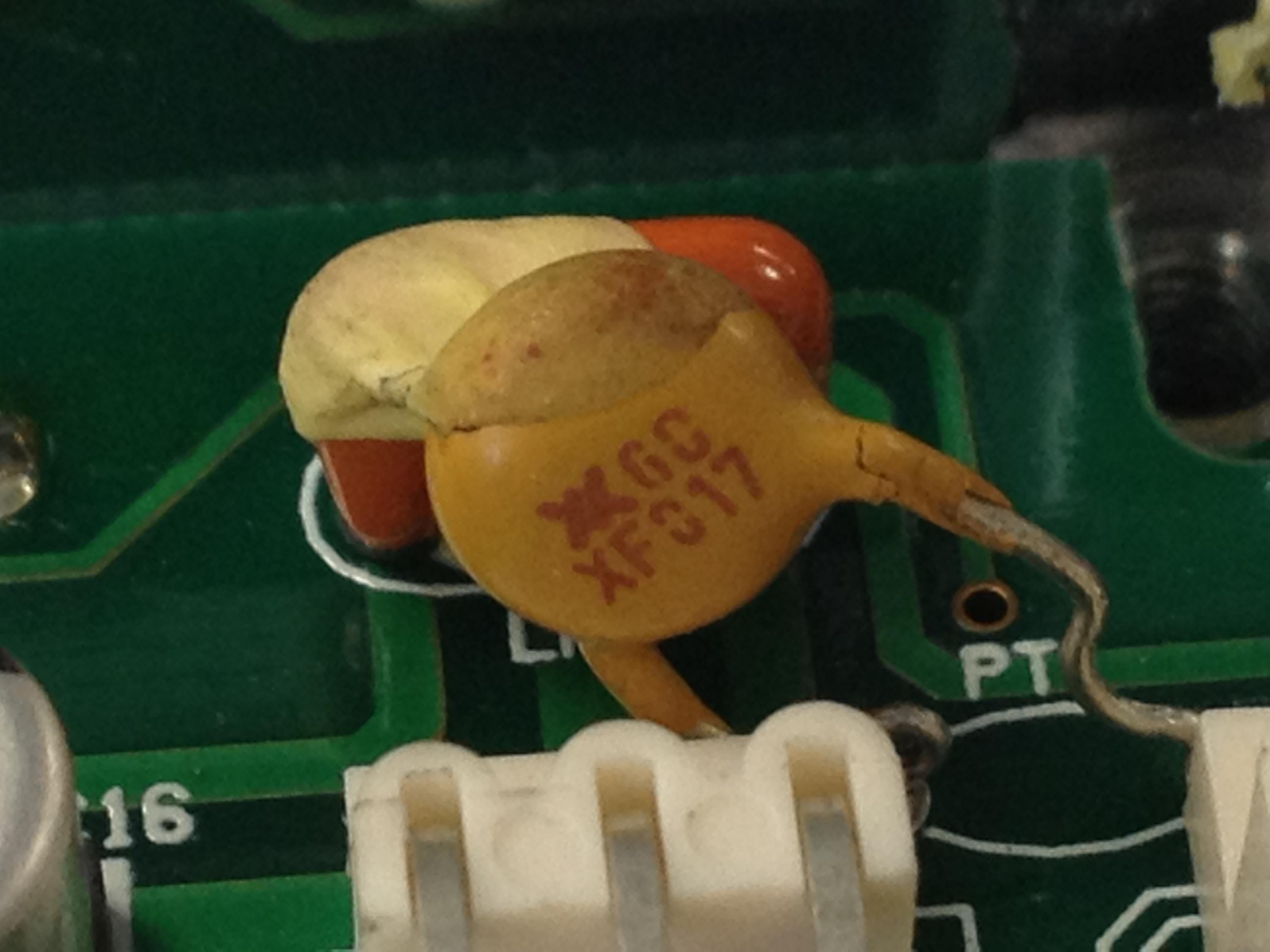

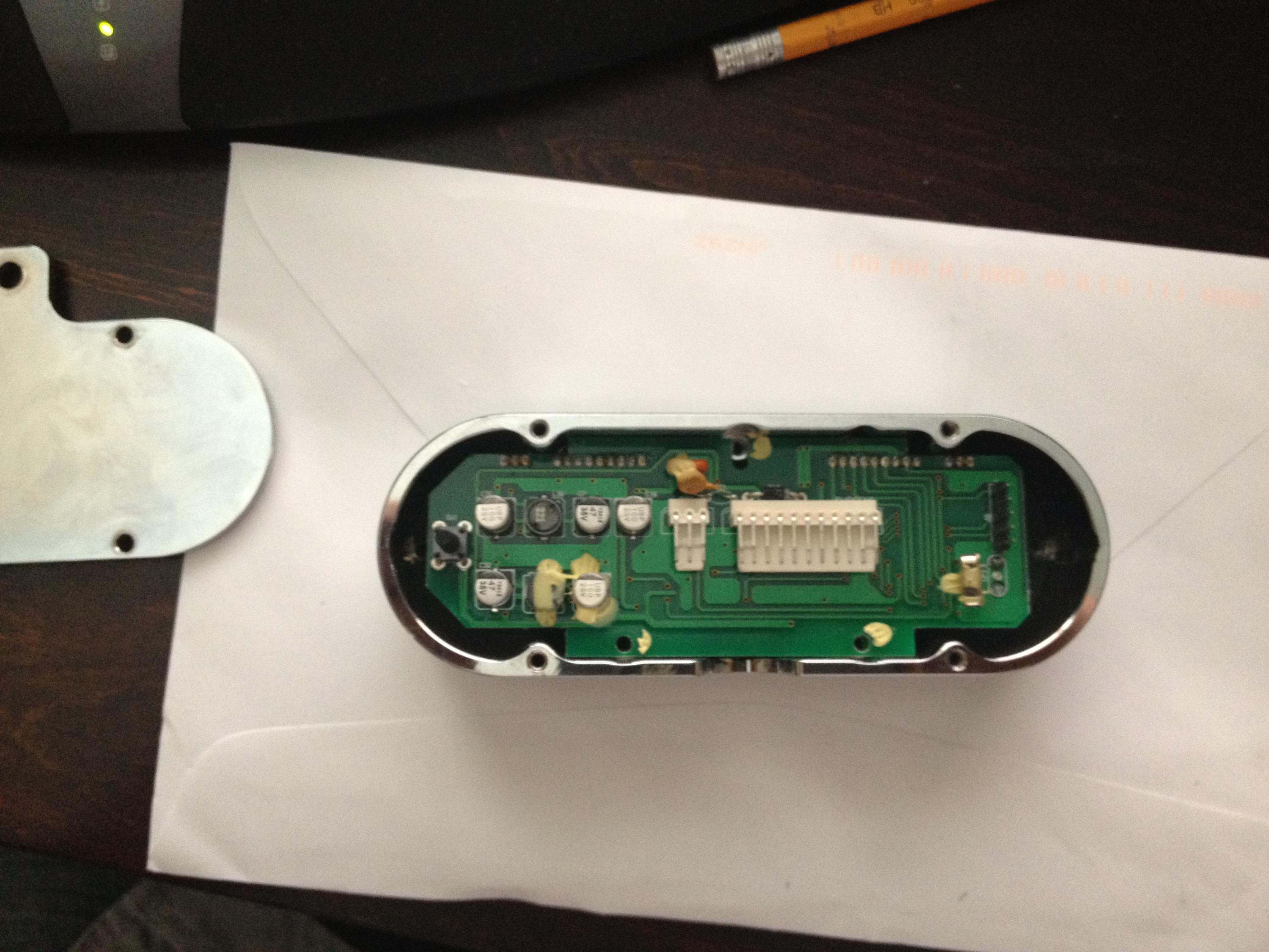

    I know nothing about this stuff but i do know that the picture of this resistor/capacitor is the problem. This is off a digital speedometer display for a custom chopper. I have had no one to this point in any of my local electronic stores able to find out what this is or a replacement for it. Please help

    Hi - I believe it is one of these
    RXEF017 60V 0.17A DIP-2 X60 XF017 Polyswitch, Resettable Fuse, PPTC
    http://www.digikey.com/product-detai...017-ND/1045822
    I am surprised that if you dont know what it is, you know that it is faulty?
    How did you test it?
      Maybe from the crack on the right leg?

        Re: Help Identify
        Thanks for your help! I know its faulty because the guy at one of the electronic shops tested it somehow and told me it wasn't working but he was unable to find a replacement part as he couldn't figure out exactly what it was. And yes that made me skeptical...sorry about the way i posted those pictures.

          Re: Help Identify
          Would you mind telling me what this part does? Basically I have a board that sometimes comes on then goes off immediately. Im hoping this part fixes the problem.

            Re: Help Identify
            See
            http://en.wikipedia.org/wiki/Resettable_fuse
