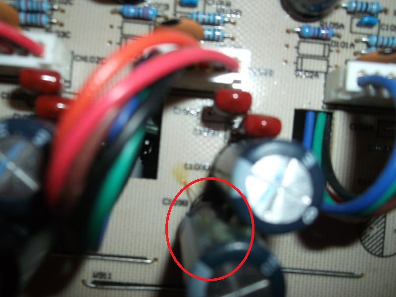

      Trying to find any information on this capacitor rating.
      It's an LTEC cap, LGZ series.
      written on it is the following, (not in any order) :
      LZG105°C(M)
      4803T
      ANV
      6813R
      Again, I am trying to find rating and capacity. I checked LTEC's data sheets, but those aren't of any help to me.
      Anything anyone on here can do would be great!
      Thanks again!
      Mike.

        a picture of it might help also what is it out of. A picture of its placing on the board might help

            Re: help can't find replacement caps!!!!
            Here's the datasheet:
            You can make some deductions based on the diameter and height of the capacitor.
            ex if it's 8x11.5, then it can be
            680uF 6.3v
            470uF 10v
            330uF 16v
            220uF 25v
            ... at least it narrows down the possibilities. You might be able to determine the voltage based on other capacitors around it.
            Post a picture of the board so we might be able to determine from the components around what voltage may run around the capacitor. It doesn't help much, because you may have 5v in the circuit but they could have picked a 25v capacitor so that they would be able to buy a ton of 25v rated caps and just throw them at the board. But it's better than nothing.
            Still... pictures, pictures...
                        Main board
                        This row of capacitors all appear to be identical, however none have any relevant supply ratings
                        http://i117.photobucket.com/albums/o...e/DSCF0536.jpg
                        Main board with ID markings.
                        http://i117.photobucket.com/albums/o...e/DSCF0537.jpg
                        Close up of capacitors
                        http://i117.photobucket.com/albums/o...e/DSCF0538.jpg
                        Surrounding components
                        http://i117.photobucket.com/albums/o...e/DSCF0539.jpg

                            • Evil Lurker
                              Warranty Voider
                              • Feb 2011
                              • 454
                              I don't think your looking hard enough. I can see the ratings on one of the caps in the picture, but they are too blurry to make out. The ratings should be on one side of the stripe running down the side of the cap and the LTEC logo on the other side.

                                • lionhearted.mike
                                  • Apr 2012
                                  • 14
                                  I took some better photos of a particular capacitor i removed from the board.
                                  It's the same size as the others with the same markings.. Shown in the links below.
                                  http://i117.photobucket.com/albums/o...e/DSCF0541.jpg
                                  http://i117.photobucket.com/albums/o...e/DSCF0540.jpg
                                    680uF 6.3v
                                    470uF 10v
                                    330uF 16v
                                    220uF 25v
                                    there are a lot of 25v 47uf caps around it..but the one i photographed individually is larger than the labelled ones..
                                    I managed to get a rough measurement. it's about 23 mm long and diameter of about 13 mm. Does that help?

                                    • lionhearted.mike
                                      • Apr 2012
                                      • 14
                                      ok, I think it's 10 V 1500 uF. based off the rough measurement.. Thanks for all your help!

                                      • mariushm
                                        • May 2011
                                        • 3799
                                        That helps a bit... but I think you mean mm.
                                        You look a bit in the datasheet and find the ones that are the closest to that size.
                                        I see either 10mm x 23mm or 12.5 mm x 25mm, I would say the first is more likely...
                                        6.3v 2200 10 x23 1650 0.042
                                        10v 1500 10 x23 1650 0.042
                                        16v 1200 10 x23 1650 0.042
                                        25v 820 10 x23 1650 0.042
                                        If I were to make an educated guess, I would think they're 820uF 25v.
                                        But just to be on the safe side, I'd replace them with 1000 uF 25v capacitors ... 1000uF is 820uF + 20%, and it's 1200uF - 20%. Almost all electrolytic capacitors have a +/- 20% rating, so 1000uF would be right in the middle of both values.
                                        But it's very important to understand it's just a guess, in real world I would just go ahead and buy a 8-10 euro multimeter with capacitance reading. Or even simpler, just desolder one of those capacitors and go with it at some store selling multimeters and just ask them to let you determine the value with one of their multimeters.
