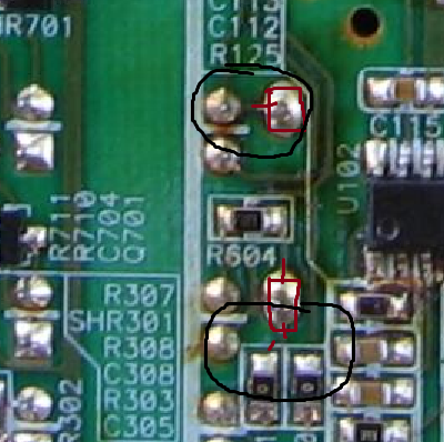

    Viewsonic VX2835WM broken trace question\
    power board on Viewsonic VX2835WM ,Found a resistor that look like it was pushed out, had one visible broken trace! the top black box i know it just runs to the diode to the left, the bottom black box! not sure of trace route as board a bit ugly an not really visible signs of trace~do both north ends of jr10 an jr11 goto south pole of r125(i think) or just jr11? then does it continue through to r604 west pole? hate when ya get hardware that was messed with before ya get it!
    thanks

    Re: Viewsonic VX2835WM broken trace question\
    I am not really sure what you are asking- if you hold the board up to a strong light can you see the traces?.
    Have you looked at Mr Fibbles' pics This one seems to cover the area you mention and some of the traces are visible?
    https://www.badcaps.net/forum/attach...7&d=1330769791
      ya think i figred them out! was looking at that pic, had a friend with better eyes show me! lol./../ thanx for your time!
