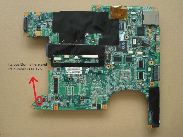

                    DV9000 Board Capacitor #PC176, Wats the Value plzzz???
                    Well! after several attempts I have come to a conclusion tht there is no way of finding the actual value of a Bad SMD Capacitor (Ceramic) unless you have a genuine schematic.
                    But, There is a Simple Way Out
                    if someone who has this board can favor to just measure this component and post its value here.(if your's is not bad either)
                    Its the PC176 in the power section of HP-DV9000 laptop Board.
                    (Please see the attachment for its position on the board.)

                        here is a schematic for the HP-DV9000 hope it helps

                            Thanks a lot aftonr. I am not sure how to refer to schematic diagrams, but let me try.
                            Thankyou again. Would it be exactly same for all models Or could there be any sub-models?
                            Thanks again.

                              But as aftonr was kind enough to post that schematic, it looks like may be in luck!
