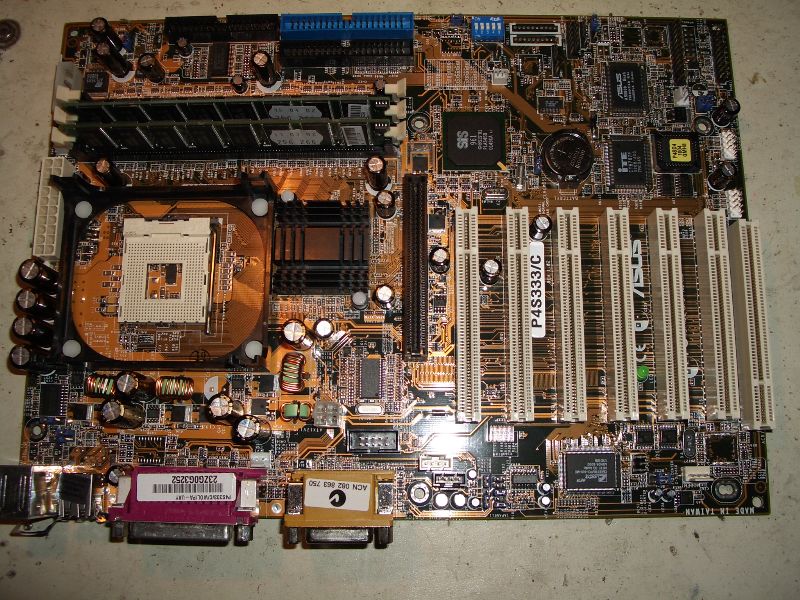

    I have just received an ASUS P4S333/C mobo. It is erratic with I suspect cap problems. It is loaded with Taicon caps in the critical areas of VRM input and outpur and DIMM decoupling.
    There are no obvious signs of bulging yet.
    Any feedback welcomed.

      Erratic means suddenly presents a black screen or freezes. I have now recapped the whole board (24 caps). I will not be able to test until I recap the PS, there I have to find 3300u 16V that I will have to buy in.
      The Taicon web site does not allow access to any cap data. But they have a heading NICHICON LINE. The caps have the same ID code. The green caps are HD (Nichicon high reliability) and the black and gold (3300u 6.6V) for VRM output are HI, not a currently listed Nichicon code.
      I have also replaced a 470u 16V Licon on the AGP card.
      Thanks Willawake. Maybe the above is of interest.

            Thanks guys. Taicon may be alright. But time was pressing so I replaced all caps in PSU, motherboard and one on graphics card. 30 in all.
            The system is now very stable.

                Just to contribute a little more. Here is the pic of the recapped mobo.

                  What's that backwards PCI slot positioned a little forward of the others at the extreme bottom?
                  The great capacitor showdown!
                  • tiresias
                    • Feb 2006
                    • 489
                    Re: Taicon caps???
                    That's one of those less-than-totally-useful ACR slots...
