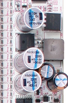

    Sapphire mobos like the beauty PI-A9RX480:
    http://www.sapphiretech.com/en/produ.../117image3.jpg
    ...are using Rubycons (great choice) and Nichilons as the solid polymer caps.
    So, my safe question is - is not the Nichilon just something like rip-off name for caps? Like the Rubycon fakes "Rulycon"
    Anyone know something about the solid polymer caps and good brands of them?

        See bottom right of the photo.
          Re: Nichilons?
          ok got it now. looks like it says nichicon though

            Oh sorry, they also don't appear to be solid polymer caps... Any other photos?
              Re: Nichilons?
              They look like bare can lytics.

                they are not polymers they just have no pvc sleeving to be more environmental. Nichicon HD series. I wonder if they changed the text and logo. Here is the one we are used to :
                the current datasheet is no help it has them with sleeving

                  It appears that it still says "Nichicon". It didn't see "Nichilon" on those caps.

                    Looks like at least thirteen polymers scattered across the mobo. Or are they surface mount wet types?

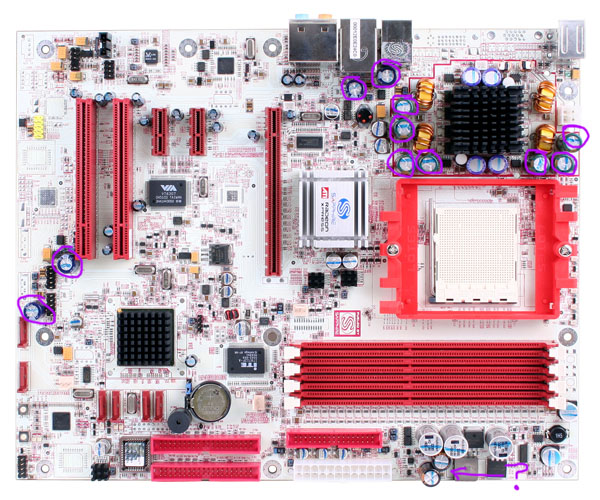

                      I think that there are only 4 polymers in the VRM.
                        Re: Nichilons?
                        for polymers it has 4 oscon SP and two chemicon chip type
                        otherwise it has lots of teapo and nichicon UD chip type along with HD we already spotted.
                        nice to see they used heatsinks in quite a few locations. also interesting to see quite a few apparently tantalum caps.
                        overall though it is a pity about the teapo but it could be worse

                          Those are Nichicon HD series, as willawake said.. They're not particularly new, as i had a factory recapped KR7A-133R with a pair of those type in the CPU VRM.
                          I've also seen them on some Xbox motherboards.

                            Mmmmmkay, the used admited that he repeatedly did typo and they are Nichicons in fact So... beat him!
                            Not me, pls. Therefore the whole thread is pointless, eh
                            Sorry guys.
                            willawake - yep, they are a bit different, probably new design? But they key point is, that they aren't polymers

                              Here are the caps to replace. I dont know what the two next to the nichicon HD are, perhaps also nichicon?
                              are you going to get some oscons to play with sometime? you can get them from waifong. it would be nice to put all oscon in vrm. they draw a red box on the board already for where you should put oscon. the ones i have not circled are the oscon sp.

                                  willawake - aaaah! Bad pic!!! The pic show a pre-production board witch was send ("great" idea) to some reviewers and - this come as no surprise for BadCap users aware of Teapos - for some one them the board died and for few the caps blew out
                                  The funny part is, that this make Sapphire switch to Rubycons and Nichicons for production baords and you can't find a single Teapo on this mobo now
