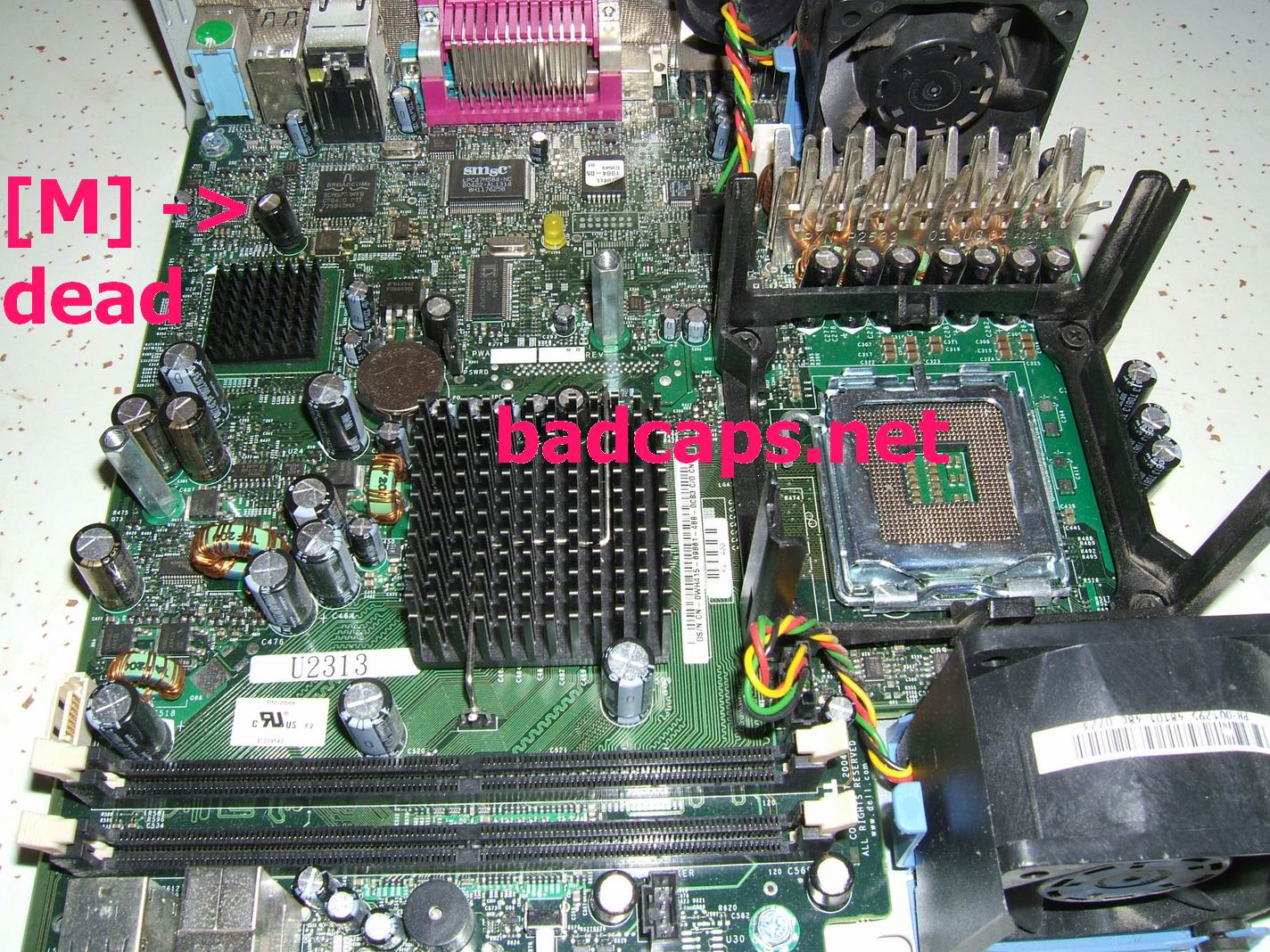

    On this SX280 Phrizbee there are 3 bulged Nichicon HM 2200uf 6.3 and 1 bulged Panasonic FJ 820uf 6.3v. All are in the vicinity of the north bridge and south bridge. A flaky SATA controller is possible. Other boards where the only bad caps are in Vcore by the CPU should not have SATA problems.
    The amount of bulge doesn't correlate well to the degree of failure. Caps with large bulges can still show pretty good on a meter and caps with small to no bulges can be completely gone. Only an ESR meter can tell with any certainty.
    Mark this day in history. That's my first ever Panasonic failure from heat. I thought it would desolder itself before bulging. If an SX280 is packing enough heat to cap a Panasonic, capacitors nearby should have been vaporized. No doubt others will lose their Panasonic virginity viewing this picture.

      Mark this day in history. That's my first ever Panasonic failure from heat... No doubt others will lose their Panasonic virginity viewing this picture.
      Just did. I thought Panasonic were indestructible. Dell really must have worked hard on the design on those GX280 in order to make it cook Pannies.
      Is it the picture, or has the Panny really blown its bung from the bottom?

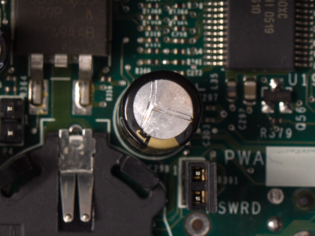

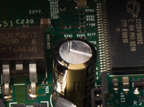

        I'm attaching some pictures of the probably bad capacitor over the 3v battery with this message. I did not see the other capacitor when I took this photo as I had not disassembled the computer. The other capacitor is over the southbridge(?), same voltage and capacitance as the one around the 3v battery.
        I think I'll go ahead with purchasing some new capacitors for this unit. Should I also replace the large ones just under the southbridge (when looking from the front of the computer) ? They look perfectly fine but there may be something wrong with them that I don't know about without taking a reading.

          Re: About to purchase Caps for Dell SX280
          the one next to your cmos battery? looks like the vrm for your southbridge, Id imagine that could be your hard drive detection issue right there
