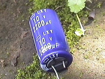

    Anyone know, where to buy them? Europe preffered, as I'm from it...
    The story go like this. Im fanless maniac. I also like to OC a little Recently I have some stability problemy on clocks, where things worked well before. And I just realized what my problems was - the caps blown with loud explosion on my mobo, so now Im in process looking for 1500uF 16V low ESR caps.
    I also found out, that the caps are made by Chemi-con and their type KZG aren't even optimal for mobos! KZG versions are low ESR/impedance ones, correct ( - compare to - ) yet they did not handle well impulse currents. Okay, they even claim "Super low ESR/impedance", but the sheet did not show any values.
    Now check this out - they also made considerably more pricely LXY/LXZ versions of caps, specificaly engineered for long-live with impulse currents AND low ESR as well, as the KZG ones has!
    Sure, they cost 250% of the KZG line, so DFI use the cost-optimized version and the results are that after 1,5 years they explode...
    Not to mean the time degradation - now is pretty clear for me, why 2700Mhz was not a problem at start, yet recently it was complete lock-up. 2600Mhz was stable last winter, yet not this winter and the list could go so on and so far - no wonder, there are 6 (!) 100uF caps missing only in the PCI section a rather large cap close to the 12V support is missing too (that's wher the two ones that died was) and the 4 caps close to the main PSU connection are nowhere near to be found as well - not to mention what is missing into the CPU socket and close to the ram voltage regulators...
    So much for DFI.
    So, anyone know, where to get quality stuff?

      The interesting thing is that KZG is rated 2000hours at 105oC for the full range (case diameter 8-10mm) whilst LXZ is rated 2000-8000hours at 105oC but it depends on case size. At 8mm it is 3000hours and 10mm 5000hours. The 8000hours is only for 16mm case diameter.
      But the lifetime ratings mean that not only the capacitor is raised to a temperature of 105oC but it is subjected to voltage with the rated ripple current for those number of hours.
      so when you have
      KZG 1500uf 16v - ripple current 2550 (2000 hours)
      LXZ 1500uf 16v - ripple current 1690 (5000 hours)
      it doesnt look as bad as before because the KZG are rated for higher ripple current (which we want) and have lower impedance 0.013 as opposed to 0.037 for the LXZ (which we want also).
      It must be emphasised that the ratings are for 105oC which you should not see on a motherboard. If you run the cap at lower temperature the lifetime increases.
      It would be great to see pics of your busted KZG caps, i dont remember seeing that before. what psu are you using anyway. You note that you like fanless AND overclocking. Did you ever record the ambient case temps? it would be interesting to know that.

        "Loud explosion"? Are you sure your P/S didn't fail and apply 18V or higher? I've tested a lot of lytics past the point of venting, and the only times I can remember audible sounds was with significant over-voltage.
        LXV, LXY, and LXZ use a somewhat different electrolyte technology than do KY and KZ(#) series caps. The latter are lower impedance and less expensive; if you want longer life, KY and, IIRC, KZH are 10K hours in larger cans size. KY and KZ(#) series caps don't do as well as LX(#) series caps at -40C and colder. With no voltage or load applied, KZE parts will swell and vent at 140C-150C; LXV do so at ~10C higher.
        Heat kills components! For every 10C higher, the life of a component is cut in half. With semiconductors, going above 150C or 175C junction temperature (Not ambient temperature! Junction temp is higher than ambient.), depending on rating, is destructive. I'd rather put up with a computer that sounds like a helicopter than fry a computer. OK, I exaggerated a a little about the helicopter part.
        PeteS in CA

            willawake - now there are some pretty valid points, sir The higher ripple current of the KZG line somewhat suggest that they could do better job in mainboards, while the suggestion (and price) on the merchant (Czech, so link would be useless, if you did not want go into translating) suggested othervise...
            I could get there now the EXR Hitano caps. 2200uF for16V, yet the specs aren't as optimistic as with the KZG series:
            relatively high impedance - 0.039 ...and somewhat low rupple current - 1660
            It is for 100kHz, so I hope this ïs the standard frequency and the other ratings are for this one as well, found there: http://www.commerce.com.tw/hitano/e/next-01c.htm

                  trodas, the lowest impedance types I'm aware of are: UCC's KZJ and KZV; Nichicon's HZ; Rubycon's MCZ (if I recall correctly). However, if what is destroying the caps is external heat, the internally generated heated, due to the impedance, may not be the most important factor. 125C parts: Nichicon BT; UCC GPA and GXE.

                    Chemi-con KZG 1500uf 16v - impedance 0.013 - ripple current 2550 (2000 hours)
                    Chemi-con LXZ 1500uf 16v - impedance 0.037 - ripple current 1690 (5000 hours)
                    Hitano EXR 2200uF 16V - impedance 0.039 - ripple current 1660 (1000 hours)
                    Since I had a problems with sound last time, it is obvious that the cap's did not make it well on the PCI slots and Audigy2zs. Therefore Im affraid that I should use the caps that also have at least a little bit bigger the ripple current that the 1500uF Chemi-con KZG ones, aren't you agree, guys?
                    Now, what caps could give sich currents, withstand 105C, have super low ESR and very low impodance + very long lifetime?
                    And mainly - WHERE I could buy them???
                    Chris1992 - yes, 125C ones are sitting right next to me on testing2 mobo-machine
                    Rainbow - true. I got similar problem on Epox 8RDA+ before. They bumped, leaked and then the mobo died. The mosfets died too as consequence. I had to disable the maximum current protection for reasonable overclock, witch might play a part too...
                    PeteS in CA - well, I drilled a hole trought the back plane, the mobo is screwed to, and planing add a little heatsink using two sided thermal tape on the mainboard, just bellow the CPU mosfets. I believe it could help a lot, since mosfets dissipiate the heat to theit metal plate, witch is soldered to the PCB and therefore adding a heatink (any thanks to the holes leting the thing ventilate) might help a bit. Tough I can't find the tape, damn. Hope it is easier to get that the caps...
                    And you put right the question - what destroy them. I think it is their own resistance/impedance rather that the heat itself. I think this way, because they just just inch down from the there 3300uF 6.3V ones for the CPU, and these aren't even bumped a little. 100% good. And since the heat travel up, then I think is is safe to assume that the heat was come from the internal workout of them.
                    Therefore not onyl super low ESR is need, but also the maximum ripple current is very important. And took into consideration maybe even bigger that 2200uF ones to replace the died 1500uF ones...

                                You're comparing Apples and Oranges - that Philips cap has a lower ESR and higher Ir because it has much higher capacitance and lower voltage. When ranking caps, compare similar values only. The LXY has higher endurance.
                                Also check out Nichicon PW and HD - low ESR, high Ir and good endurance. The HD is also available in lacquered bare-aluminium finish that looks cool, especially for those who use windowed cases/blue LEDs or for vintage audio restoration.
                                In PSUs, the common failures are mainly on the secondary side, on both sides of the pi-filter after the rectifiers. Check out the primary-side flyback cap on the ATX auxiliary supply also.
