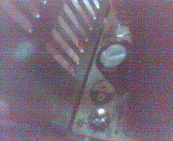

    Why does this Hermei cap have Panasonic's T vent on it?
    I saw this in an L&C LC-B450 E power supply. It is a Hermei 1000uf 10V 10MM cap with Panasonic's T vent.
    Now, why does Hermei cap have the T vent that Panasonic has?
    (Sorry, had to take this using a 6-year old Logitech Webcam)

        That T-vent is different from Panasonic's T-vent. Panasonic's is a single arc, slightly concave upwards. This one has two arcs, concave downwards. At least, that's what the pic looks like.
        • Newbie2
          • Sep 2005
          • 885
          Re: Why does this Hermei cap have Panasonic's T vent on it?
          I am comparing that Hermei cap to a genuine Panasonic cap right now, and by my eyes the Hermei cap, at the top of the T it is curved a little bit more than the Panasonic. Almost identical.
          What is Hermei's usual vent?

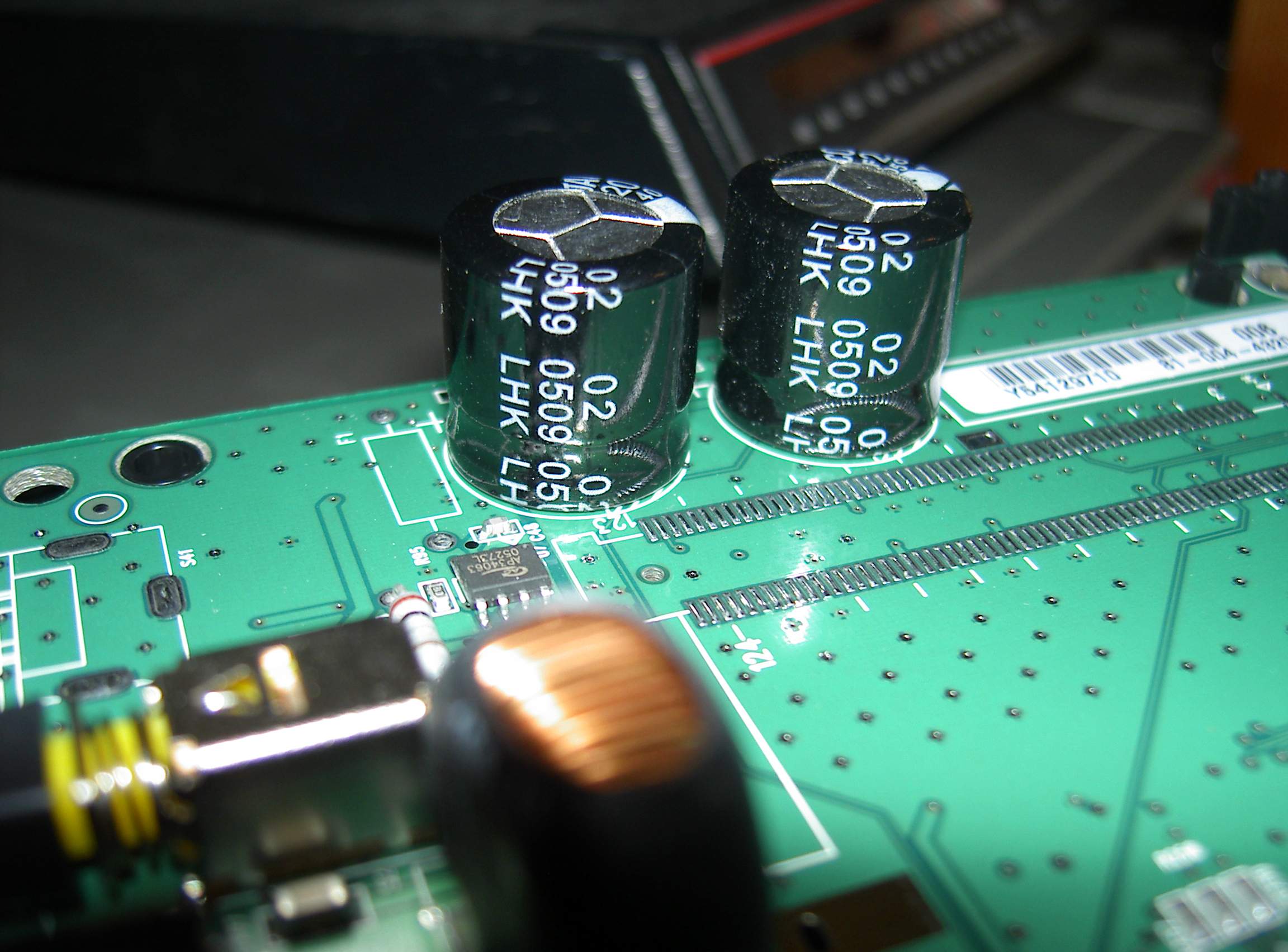

            Hermei's usual vent is IIRC a honeycomb that looks something like >-<

              several manufacturers use similar vents to others. agreed that hermei normally uses the honeycomb vent. i have seen them using the X vent also.
                Like this?
                  Originally posted by Newbie2
                  Like this?
                  Something like that :P
                    yeah, what Per posted. I was too lazy to dig up a pic.
                      I've seen Teapos with this vent too.
                        I've seen 1997 Sanyo with a similar vent. Also Jamicon.
