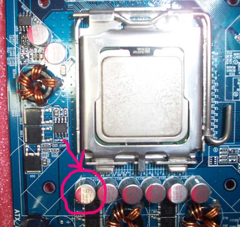

    Right, my problem is with my laptop. I suspect bad caps, I have done continuity tests on them and most failed. Is this type of test okay? Basically if the cap is shorting I will get a current pass through.
    The picture is one that I have taken from this forum but I have circled what I need to know, are these are caps? As when I do the continuity test it fails is ment to let current through?

    That is correct, continuity should fail otherwise you have a connection between positive and ground which will obviously lead to a shortcircuit...
    The caps you show above rarley fail... (still it does happen)
    It is usually pretty obvious if they indeed have failed though, being visually thicker on the sides or blown top or bottom with allot of electrolyte all over the place...

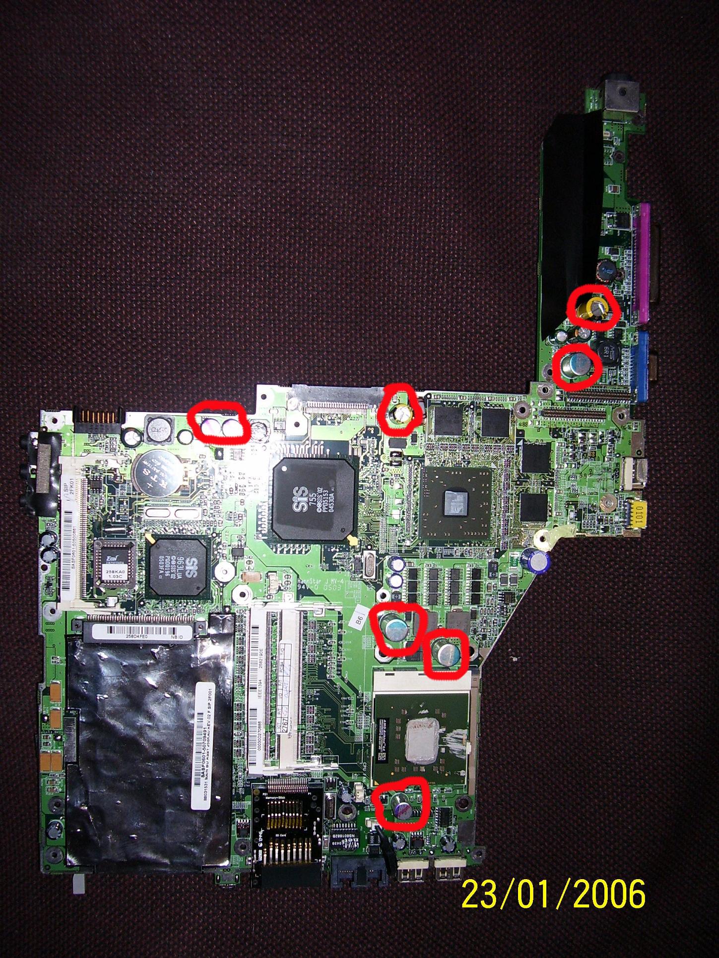

          The laptop brand is Fujitsu and motherboard is 258KAO. I have taken a photo of the m/b and circled the problem caps.
          The metal ones all fail the continuity test which seems odd, maybe it's not. And it looks like the two yellow caps have failed too.
          I'm doing the continuity test on a multimeter set on 200ohms. I think this is a safe setting, do correct me if I'm wrong.
          Please click on the Motherboard link
          I forgot to add the cap near the battery it's a Teapo 220uf 25v

            I don't think you have a problem with the caps.
            Testing caps in-circuit with an ohm-meter does not give you any useful result as there are other things connected parallel to them (such as CPU or chipset).

                  you indicated almost all of the good caps on the board. all the major caps are polymer caps except for the 2 teapos. i would only really worry about the teapo caps but they are quite small values.

                        From the pic, I can see that there's too much thermal goop on the CPU - Arctic silver or whatever. Carefully clean it out and re-apply a smaller quantity on the die *alone*. Reseat the CPU. Reseat the DIMMs. Did you attempt a CPU upgrade and does the BIOS support this CPU ?

                          The caps do look okay I must say. The CPU is original and the thermal gunk, well, I done that whilst taking it apart.
                          I did reseat the ram and cpu b4 I took it apart, I even took out the dvd drive and hard drive trying to elimiate the problem that way.
                          If the CPU is faulty would I get the same problem? The CPU is a AMD 64 3200 Hammer.

                                      After stripping it down to the m/b and not finding anything wrong, I decided to rebuild it and guess what? It bloody works!!!!
                                      It's been stable for 7 days so far
