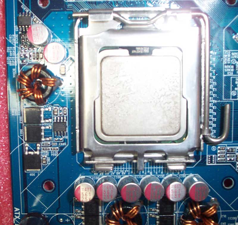

    A motherboard of mine is acting like it has bad caps.
    http://www.gigabyte.com.tw/Motherboa...I865GM-775.htm
    I've replaced the normal caps and the problem persists. There are smaller unwrapped sold can caps (like on a lot of video cards these days) around the CPU socket that look a little odd so I want to try replacing them, but I can't figure out what they are. The markings are:
    4y1
    561
    2.5V
    There is a symbol (I assume manufacturer symbol) sort of like anf F or E with a line directly above or below it. All printing is red.
    _
    F
    _
    Any help in identifying the capacitance value would be greatly appreciated (I'm assuming the voltage rating is 2.5V).

    Re: Need help identifying caps
    fujitsu solid polymer .
    are the tops domed?
    common failure with these.
      Thanks! Hopefully that will narrow down where to look for the capacitance values.
      They aren't domed, but several look corroded/cracked on the side.
      I already RMAed the board to gigabyte and they sent it back (after a month and half) in the same exact condition (board randomly shuts down after posting).
            I'll try to get a pic. My digital camera isn't the best, though.
            They are through hole, but they look like the SMT kind that are on video cards and such.
              OK, I managed to get a decent pic.
              • linuxguru
                • Apr 2005
                • 1564
                The caps look OK to me - but SPAs can fail silently without bulging or leaking.
                • BigBadBiologist
                  • Jan 2006
                  • 9
                  I'm not totally sure if they are bad or if they are just not strong enough. Like I said before, several of them look odd on the sides (camera couldn't pick that up), but they get really hot when the system is on and the mobo randomly powers off. It is the same thing that happened to me once when I put caps on an 8kha that weren't the proper ESR rating.
                    have you checked in the psu to see if you have badcaps there. I am not sure about the brand of those caps. They appear to be 561uf 2.5v polymer caps radial lead
                    They are not fujitsu as they only offer the yellow ones in radial or bare aluminium smt type only. neither are they oscons. assume the worst i guess.
                    you could recap them with 1000uf 6.3v. better to use the lowest esr caps you can find. are those caps 8mm. you will have to find same width replacements.
                        the f logo suggests they are fujitsu unless impostors are now counterfieting these too.
                        and the 561 is the value.
                        first 2 numbers are the value and the third is the number of zeroes that follow.
                        so 560 uf.
                            Well, I replaced the caps with 1000uF 6.3V caps and the problem persists, so that is a bit of a disappointment. The caps are getting really hot though, so it makes me think that they just need to be a higher voltage rating or something.
                              The caps can be expected to run warm, but not hot. If you think they are unreasonably hot, then something else is likely to be the problem. You don't say what abnormal symptoms the computer is displaying, or the condition of the power supply. A 6.3v rating is more than adequate, if the original caps were rated at 2.5v. A possible cause could be high ripple, resulting from a degraded on-board VRM or back at the PSU. Can you measure the voltage across the caps, and if possible, also measure the AC ripple voltage?
                                You need ultra-low ESR types like the Rubycon MCZ or Samxon GC/GD to replace SPAs.
