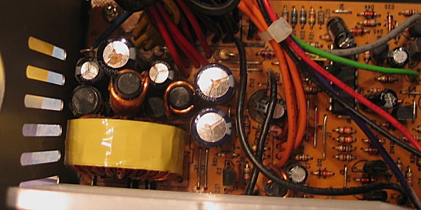

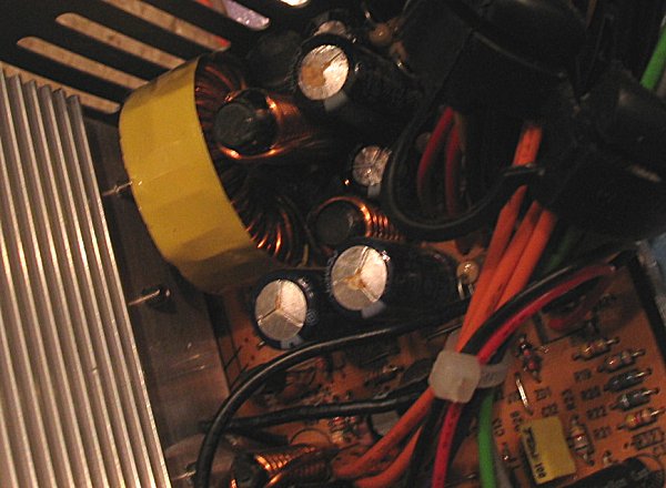

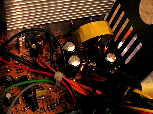

                      Yayyy! I've installed a new PSU and the system boots normally now! Even better, there used to be a slight case of interference on the monitor, and now it's gone! This system has always acted kinda strange. It's 2 1/2 years old but I suspect some of the components are older. In the past months this system suffered from a dead monitor, a dead keyboard, 2 dead CD-ROM drives. A serial killer feeding on peripherals.
                      My new PSU is a 350W Enermax with a lot of cool options. It's got a dual fan, is adjustable, not noisy at all, and has a 3 years warranty. At 70$ it's a very good value.
                      Now, for the old PSU, I have some more news. I've found the sticker on the back of the unit. It's a "L&C Computer Co., Ltd", model is "DR-A300ATX". YOU SHOULD NEVER BUY ANYTHING COMING FROM THIS CRAPPY COMPANY. This PSU is most certainly the cause for all my problems, from fried peripherals to the latest boot problems.
                      I've opened the PSU and I've found the ugly part. FIVE CAPACITORS ARE DAMAGED. Three medium size caps are swelled, and discharged from the top. Two huge caps seem to have leaked from the bottom.
                      Unfortunately I don't have my digital camera right now, but I'll keep the old PSU and post a few photos when I have the time.
                      Here is the dead capacitors info:
                      Fuhjyyu 1650uF16V; top bulged and leaked
                      Fuhjyyu 1000uF10V (2x); top bulged and leaked
                      CapXon 330uF200V (2x); massive leak suspected from the bottom*
                      (*or it might be a sealant or an isolation foam, I'm not competent enough to tell the difference)
                      Thanks all, now my system runs smoothly. Replacing the PSU cost only 70$, an hour trip downtown and 15 minutes of easy work. I'm a happy camper.

                        Re: Computer will POST only after a dozen boot attemps
                        L&C and DEER are known crap PSU manufacturers.
                        There's a lot of bad Fuhjyyu caps recently.
                        The substance around the bottom of the big caps is most likely some kind of glue - it's present in most PSUs.

                                    • Hugo
                                      • Jan 2006
                                      • 13
                                      For the record, here's a tentative picture of the 3 caps. Unfortunately, the goo over the 2 caps on the left had dried, and it partly went away when I cleaned up the board with a vacuum cleaner.
