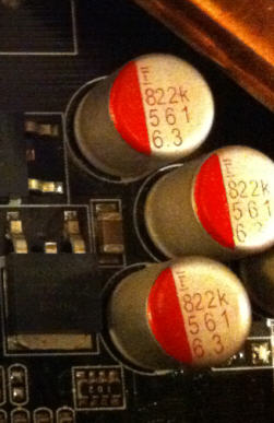

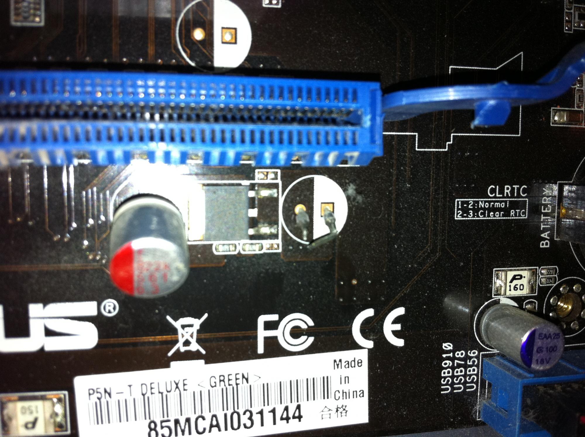

    I have a ASUS P5N-T Deluxe Motherboard. Recently decided to clean out the dust and noticed a capacitor missing. Its neighbour is not well either.
    Pic of missing cap with neighbour...
    Cap has the following information written on it:
    822K
    561
    6.3
    Image:
    I've spent an hour reading the internet for info but have been unable to identify exactly what this capacitor is. The only thing I am pretty sure about is that it is 6.3V.
    Can anyone tell me what farad rating it is?
    any help appreciated..

    Re: Need Help identifying a capacitor...
    Fujitsu
    560uF/6.3V
    I'm not sure about their type, Solid capacitor?
      Fujitsu FPCAP - Functional Polymer
      Fujitsu sold to Nichicon:
      https://www.badcaps.net/forum/showthread.php?p=62943
      Use UCC PSC (8mm) or PSE (6.3mm) series:
      http://search.digikey.com/scripts/Dk...me=565-3227-ND
      http://search.digikey.com/scripts/Dk...me=565-3255-ND
      Or use Nichicon L8 (8mm) or S8 (6.3mm) series:
      http://search.digikey.com/scripts/Dk...=493-4021-1-ND
      http://search.digikey.com/scripts/Dk...=493-4043-1-ND
      8mm sizes are higher ripple (5700ma), so if they fit, make them 1st choice.
        Thanks Guys,
        I really appreciate the quick response and detailed info.
        now to go buy some and get soldering!!
        thanks again
