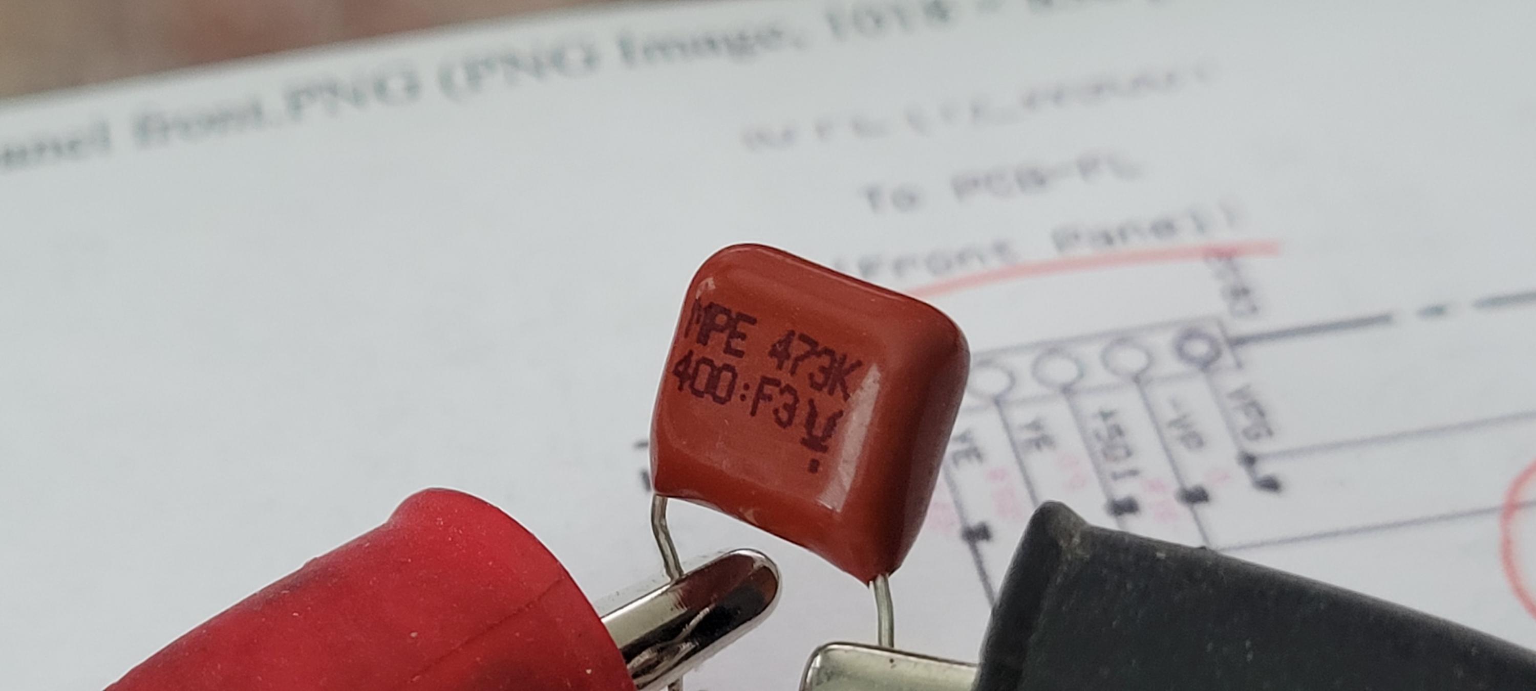

    Is this capacitor any good???
    Hi all. Just checking to make sure if this cap is good bad ugly.

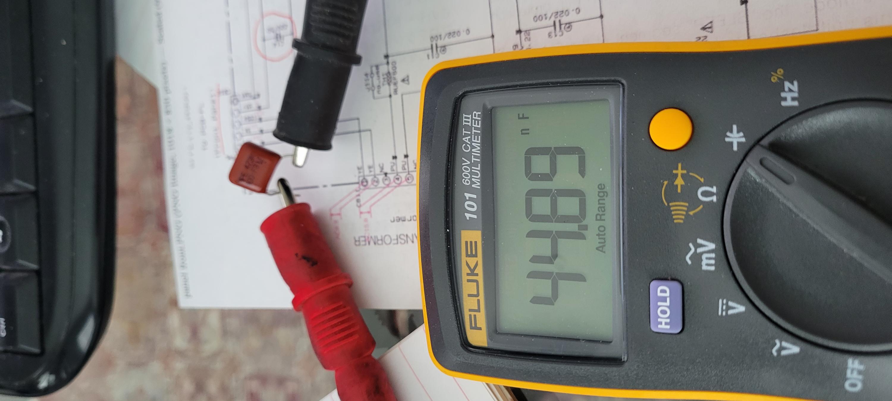

    I believe it is supposed to be .047 with a 10% tolerance. I just want to make sure Im reading this correctly.
    44.89nF or .044mF

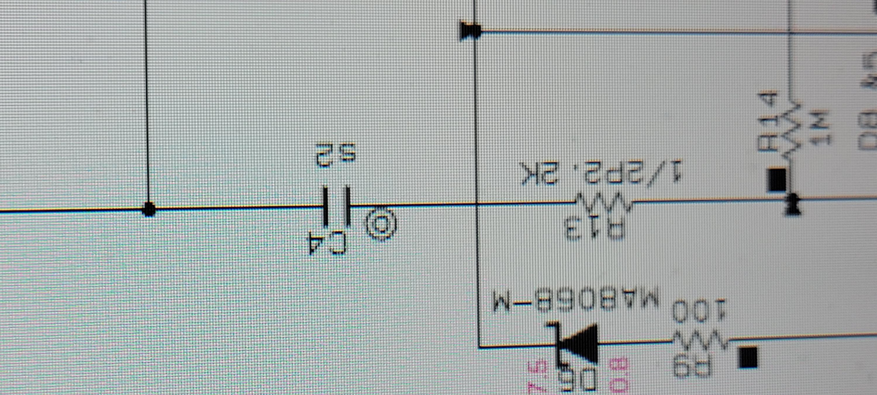

    on the schematic, it is c4
    So, it looks like it is just barely ok. what you guys think please.
    Thank you
  • R_J
    • Jun 2012
    • 9588
    Re: Is this capacitor any good???
    Yes it is good
    473 = 47nF = 0.047µf

      The cap looks fine. C4 in series with R13 2k2 1/2W is likely a snubber cap?
      • R_J
        • Jun 2012
        • 9588
        C4/R13 are used to couple the A/C line for a clock reference to ic3
        • redwire
          • Dec 2010
          • 3912
          I don't see that in OP's pics, you must have the info from another post?
          400V cap is more common for mains or snubbing.
          • R_J
            • Jun 2012
            • 9588
            OP is working on a Yamaha amp https://www.badcaps.net/forum/showthread.php?t=103447
