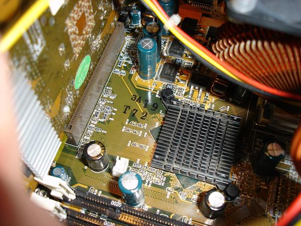

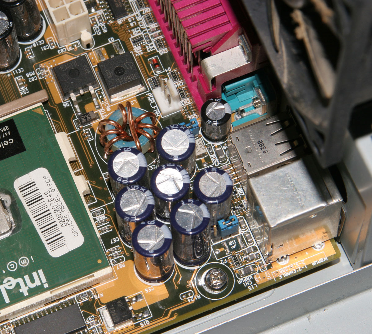

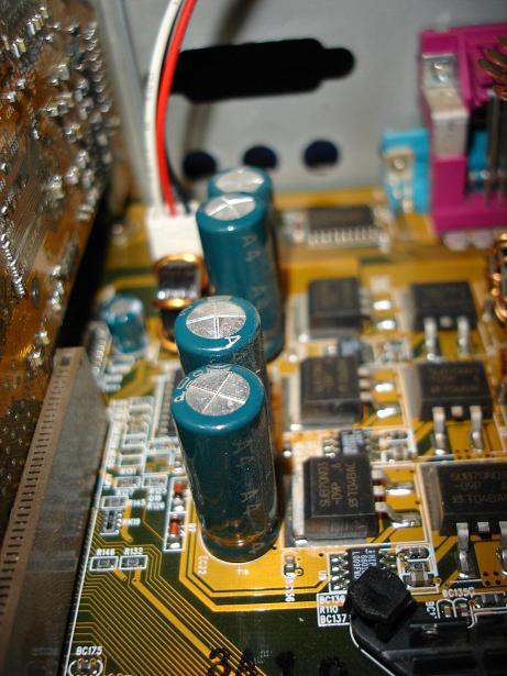

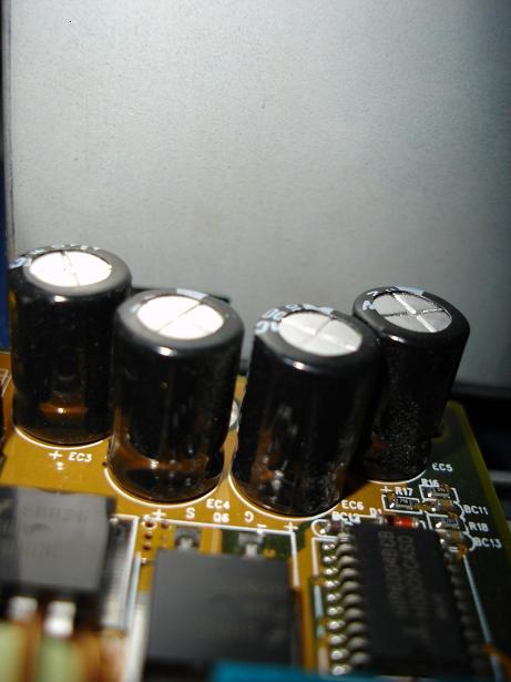

    Hey guys,
    I have a KT7 Raid MB, 256MB Ram, GeForce 4 Ti4200 AGP card and Win XP Professional Sp2 and bios A9.
    When I start click restart my computer restarts no problem, but when I do shutdown and then try to power up the PC my keyboard (PS2) isnt recognised.
    I then have to pull out the power cord and try starting the PC again. Some times this works, other times it doesnt. When it fails I'm left with just a blank screen infront of me.
    I do occasionally get it to boot into WinXP but the keyboard isnt found all the time - if I view Keyboards under Control Panel there are none listed.
    Do you think its a caps problem? I've attached some pics below.
    If so, I live in Northern Ireland - how can I get this fixed?
    Ronan

    Re: Abit KT7 Dropping PS2 and AGP Card
    I would agree that you have badcaps.
    The guys here can probably help you get the caps.

        If you fix it be careful of the 2 small caps under the AGP slot. One of the holes is very close to some traces and its easy to damage them and screw up the board.

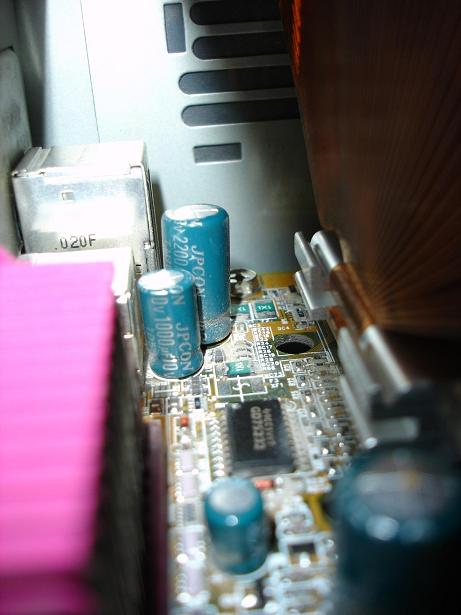

          Originally posted by ronanmagee
          Failing that I can give it a go if I have the correct instructions and the correct parts.

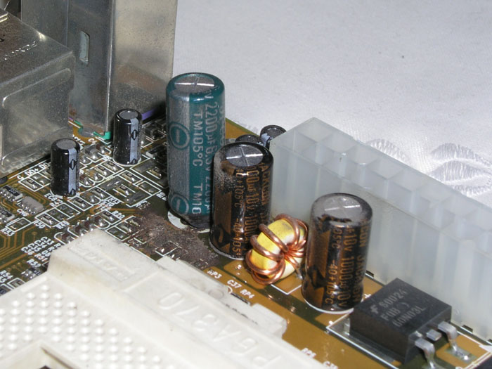

          I'd be starting with the 2 JPCON's (1000uF & 2200uF) in the last photo, right next to the keyboard connector.

                  Yes, the caps are bad.
                  I've also seen bad/broken solder joints around PS/2 connectors on Abit BX133-RAID board - there were "000"-marked 0-ohm "resistors" instead of that flat green fuses and the contact between some of them and PCB was not good, resulting in random PS/2 and USB failure. A piece of wire fixed it So if the problem persists after replacing the caps, check this.

                                    The fuses/0-ohm resistors are for +5V line protection. The fix is to solder a wire between PS/2 or USB +5V pin and a point before the fuse - or remove the fuse and solder the wire there (or a new fuse).
                                    As BX133-RAID has keyboard/mouse power-on feature, it's important not to solder the PS/2 power pins directly to +5V as the feature will no longer work if you do this (there is a jumper that switches keyboard/mouse power between +5V/+5VSB).

                                        Ronan : check the photo and see what a Jpcon will be like after a while. busting its bung out the bottom and leaking everywhere.
                                        nice find on the graphics card. post some pics to see if anything more is up with that?
                                        what are the caps like on your old board?
