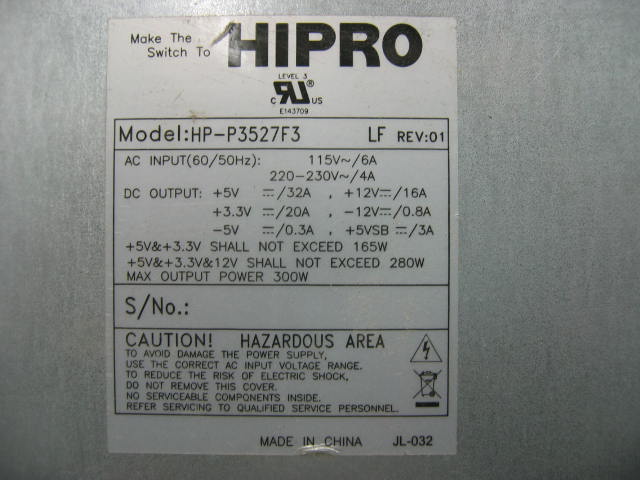

                I have this power supply (these images aren't mine) but I'm wondering if the Hipro below can do 300W in earnest (it's a HP-P3527F3 that came with a dead eMachine T6536 I used to have; better than coming with a Bestec, I suppose)? I don't think it has a PFC. It only has two Teapo 470uF/200v capacitors on the primaries rated at 85C.
                Can it do what the label says?
                Or is it more like 280W continuous, 300W max?
                I see lots of Teapos in there otherwise. It's not easy to tell from the provided picture but does anyone know what else is in there cap-wise (if you click on the last image you can still zoom in more)? Does this look like a well designed PSU or have Hipro done infinitely better and is this more like a Huntkey or Bestec?
                EDIT: Thanks Scenic and Behemot.
                  Yes, it can. The remaining 20 W is for +5 V SB, -5 V and -12 V
