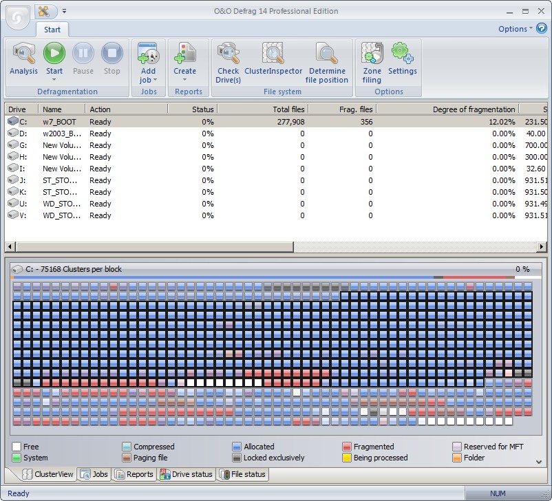

Badcaps.net Forum
Go Back   Badcaps Forums > General Topics > General Computer Discussion
Register FAQ Members List Social Groups Calendar Search Today's Posts Mark Forums Read
Thread Tools Display Modes
Old 05-21-2012, 10:18 PM   #21
Topcat
The Boss Stooge
Topcat's Avatar
Join Date: Oct 2003
City & State: Salem, MO
My Country: United States
Line Voltage: 120VAC 60Hz
I'm a: Professional Tech
Posts: 6,496
Send a message via ICQ to Topcat Send a message via AIM to Topcat
Default Re: SSD worth it? recommendation? for this computer
Quote:
Originally Posted by c_hegge View Post
I never defragment. It makes no difference to the performance and wears out the HDD. I do agree with you though on removing icons. I don't think it ever has made a difference and don't think it ever will.
I also disagree. On a badly fragmented drive using a good utility, it makes a HUGE difference! Its one of the best HDD performance enhancing things you can do.
__________________
<--- Badcaps.net Owner & Forum Administrator!!
Badcaps.net Services:
Premade Capacitor Kits
Badcaps.net Capacitor Master List
Motherboard Repair Services
If you've come here in search of replacement capacitors or repair services, please use the links above.
http://folding.stanford.edu/
Team : 49813
Join in!!
Team Stats
Topcat is offline   Reply With Quote
Old 05-21-2012, 10:23 PM   #22
gg1978
Join Date: Dec 2004
City & State: Jamestown, IN
My Country: USA
Line Voltage: 117VAC, 60Hz
I'm a: Professional Tech
Posts: 399
Default Re: SSD worth it? recommendation? for this computer
IME, the Intel X-25-M's and 320 series have been reliable, as well as the Samsung 470 and 830, in my daily use system.. I just picked up a Crucial M4 256G at newegg a couple of weeks ago for $160.. Cloned using Clonezilla from my old 470 Series Samsung to it just fine.
And to all the hater's on Vista/7, what do you intend on doing when XP Home/Pro goes out of patch support in August 2014??
Vista was shit when it was first released, SP1 fixed a lot of the snafus.. But if ya give it enough RAM, it runs just fine, fwiw. And 7's better.. :p Driver support on XP 64 bit was complete and utter shit when i was considering the upgrade when it was first released. Only in the Vista/7 generation has Windows gotten mature 64 bit driver support, with the attendant improvements.
Given a lot of the current / nexgen hardware is going to have 8Gig's of RAM standard soon enough, running an old 32 bit OS isn't going to make a lot of sense, given it's about a two year lifespan left in it.
gg1978 is offline   Reply With Quote
Old 05-21-2012, 10:27 PM   #23
gg1978
Join Date: Dec 2004
City & State: Jamestown, IN
My Country: USA
Line Voltage: 117VAC, 60Hz
I'm a: Professional Tech
Posts: 399
Default Re: SSD worth it? recommendation? for this computer
And when it comes to disabling auto java updates, adobe reader updates, etc.. THink about all the dumb users that don't know shit about updating their software before turning those off.. Being the probable first two vectors for driveby/malware infections, either don't have them installed on the system or keep them up to date..
Killing background services saves you very little in the sense of memory/CPU cycles. But paging to disk all the time is worst to be certain. Fixed size pagefile is a good idea though, i make it double the size of system RAM, except on 64 bit OS's, where it's 1.5X system RAM.
gg1978 is offline   Reply With Quote
Old 05-21-2012, 11:10 PM   #24
severach
Join Date: Aug 2007
City & State: Michigan
My Country: USA
Line Voltage: 120VAC 60Hz
I'm a: Hobbyist Tech
Posts: 935
Default Re: SSD worth it? recommendation? for this computer
Quote:
Originally Posted by gg1978 View Post
And to all the hater's on Vista/7, what do you intend on doing when XP Home/Pro goes out of patch support in August 2014??
Hooray, no more updates. I'll be almost as overjoyed as when MS announced that IE-WFC won't be made for Windows XP. No more crap IE that I need to refuse every few months.
Continue to run XP until there's an unsolvable problem. XP is teh not suck so that could take years. The more the better. I want to send a message to Redmond: Windows is done, please stop working on it.
The only patch I can recall that was really important was just before XP SP2. Someone found a hole in the TCP/IP stack allowing malware to drill, deposit, and execute itself on any target system. No shares were required. An infected machine hits everything on the network as soon as it joins.
The only other security holes are IE and OE. Webmail solves the OE problem and Firefox solves the IE problem. So long as Firefox gets security updates, WFCs about the OS!
severach is offline   Reply With Quote
Old 05-22-2012, 12:09 AM   #25
c_hegge
Unknown
c_hegge's Avatar
Join Date: Sep 2009
City & State: North Coast, NSW
My Country: Australia
Line Voltage: 240V 50Hz
I'm a: Professional Tech
Posts: 3,421
Default Re: SSD worth it? recommendation? for this computer
Quote:
Originally Posted by ratdude747 View Post
I disagree. On units with a 5400RPM or slower HDD, it DOES make a difference when fragmentation is severe. My Dell Latitude D400 once was crippled by this; a defrag (using the auslogics utility) had a large impact.
Quote:
Originally Posted by Topcat View Post
I also disagree. On a badly fragmented drive using a good utility, it makes a HUGE difference! Its one of the best HDD performance enhancing things you can do.
Worst I've had was about 30% volume fragmentation. On an 80GB 7200RPM HDD, it made no difference whatsoever to the performance. Power on to HDD settled was still under 20 seconds and there was no improvememnt at all from a defrag.
__________________
Main PC: Core i5 660 3.33GHz, Gigabyte GA-P55-UD3R, 4GB Kingston DDR3 1333, 750GB WD HDD, Sony Optiarc DVD RW, nVidia GTX295 1760MB, Antec 1200 Case, Delta DPS-750CB 750W PSU, Hauppauge TV Tuner, Windows XP Pro.
Main Laptop: Lenovo Thinkpad T60: Core 2 T2500 2GHz, 2GB DDR2, 80GB HDD, DVD RW, Intel Graphics, Windows XP Pro.
2nd Laptop: Toshiba Satellite A200: Core Duo 1.73GHz, 2GB DDR2, 60GB HDD, DVD RW, nVidia GF Go 7300 Graphics, OpenSUSE 12.2, Fan Mod
c_hegge is offline   Reply With Quote
Old 05-22-2012, 02:15 AM   #26
Th3_uN1Qu3
On my level
Th3_uN1Qu3's Avatar
Join Date: Jul 2010
City & State: Bucharest
My Country: Romania
Line Voltage: 230VAC 50Hz
I'm a: Student Tech
Posts: 3,338
Send a message via Yahoo to Th3_uN1Qu3
Default Re: SSD worth it? recommendation? for this computer
Speaking of defrag, Win7 does it automatically in the background. @ mariushm: If you disable the Background Intelligent Transfer Service you lose automatic updates.
__________________
Quote:
Originally Posted by PeteS in CA View Post
A working TV? How boring!
Th3_uN1Qu3 is offline   Reply With Quote
Old 05-22-2012, 05:35 AM   #27
mariushm
Join Date: May 2011
City & State: Romania
Line Voltage: 230VAC 50Hz
I'm a: Hobbyist Tech
Posts: 2,217
Default Re: SSD worth it? recommendation? for this computer
You will still be notified there are updates available, at which point you can just start the service. I keep mine set on Manual start.
As for automatic defrag in Windows 7, I doubt that. It would have to be a service and I would have noticed it..
Ah yes, http://blogs.msdn.com/b/e7/archive/2...rovements.aspx
I guess it uses Task Sheduler which I've disabled also, I don't have a need for it. I hope it disables itself with SSD drives, as defragmenting only hurts them... latency is identical no matter what you access on these ssd, what matters with ssd drives is just trim support (if the ssd doesn't do it itself in the background in firmware).
O&O Defrag is much better than the integrated defragmenter, so I don't use the integrated one:
The dark gray bar near the beginning is the hibernation file,
the light blue at the beginning are all the dll and kernel files,
darker blue are executables and resources and often accessed files,
brown stuff is pagefile.sys file which in my case it left in the center of partition because it determine it's not used a lot as I have 4 GB of ram so by placing it at the beginning of the drive before system files it would only hamper performance (dll and kernel files would be moved further so more disk access latency to them).
It's very nice software, you can double click on a cluster and see exactly what files are there so you can determine how well it optimized the file system.
(the fragmented files are mainly isos and avis I moved from the other drives when I did some video processing and needed extra room... o&o defrag won't start defragmenting those if there's very few fragments, it would be pointless.)
Quote:
Worst I've had was about 30% volume fragmentation. On an 80GB 7200RPM HDD, it made no difference whatsoever to the performance. Power on to HDD settled was still under 20 seconds and there was no improvememnt at all from a defrag.
It makes a lot of difference if you're low on memory. When you have reasonable amount of memory, Windows tends to keep more in ram cached, so when you launch applications, the libraries and windows files are already somewhat into memory so disk access is reduced. When you install applications in time, not everything at the beginning on a formatted disk, the files are dumped wherever windows determines it's enough space to allocate the files as continuously as possible, it makes no determination as to what purpose that file is for.
Even the integrated degragmenter, I'm not sure if it's a "smart" one. A good defragmenter moves the files based on the type (executables, page file, hibernation, dll, resource files etc) not just to have the files in continuous blocks.
O&O Defrag actually monitors what you access and on consecutive runs it will start to move those often accessed files towards the beginning of the drive to improve performance.
Last edited by mariushm; 05-22-2012 at 05:44 AM..
mariushm is offline   Reply With Quote
Old 05-22-2012, 06:01 AM   #28
Th3_uN1Qu3
On my level
Th3_uN1Qu3's Avatar
Join Date: Jul 2010
City & State: Bucharest
My Country: Romania
Line Voltage: 230VAC 50Hz
I'm a: Student Tech
Posts: 3,338
Send a message via Yahoo to Th3_uN1Qu3
Default Re: SSD worth it? recommendation? for this computer
Quote:
Originally Posted by mariushm View Post
I guess it uses Task Sheduler which I've disabled also, I don't have a need for it.
Just because you don't need it, doesn't mean everyone else doesn't. I for example use it every now and then.
Quote:
Originally Posted by mariushm View Post
I hope it disables itself with SSD drives, as defragmenting only hurts them...
It does.
Quote:
Originally Posted by mariushm View Post
O&O Defrag
And Vopt is better than O&O Defrag. It's a tiny bit of software that does a mighty fine job. Fastest defragger i've ever used. Nowadays i just let Windows itself take care of it tho.
Th3_uN1Qu3 is offline   Reply With Quote
Old 05-22-2012, 11:51 AM   #29
lti
Join Date: May 2011
City & State: Windsor, Colorado
My Country: United States
I'm a: Hobbyist Tech
Posts: 1,181
Default Re: SSD worth it? recommendation? for this computer
What is wrong with the built-in Windows defragmenter?
Quote:
Originally Posted by shovenose View Post
Which computer?
The XP Dell or the Asus X44H?
I was asking about the Asus.
lti is offline   Reply With Quote
Old 05-22-2012, 09:15 PM   #30
smason
smason's Avatar
Join Date: Feb 2010
City & State: Alberta
My Country: Canada
Line Voltage: 120VAC 61Hz
I'm a: Hobbyist Tech
Posts: 1,479
Default Re: SSD worth it? recommendation? for this computer
Quote:
Originally Posted by lti View Post
How long does this computer take to boot up?
In my experience, cleaning the registry can also break installed software and will eventually corrupt the registry, forcing the user to reinstall Windows.
There's a big difference between CLEANING the registry, and farking it up.
Using crappy tools to do it for you will definitely fark it up. Use a good tool, and check what it's doing before you approve the changes.
I'm always amazed at what crap the computer is trying to load, AFTER a program is uninstalled. Watching a system monitor trying to find and run non-existant files. A GOOD registry tool can tell if an entry is doing something silly like that, and delete it without breaking anything.
__________________
36 Monitors, 3 TVs, 4 Laptops, 1 motherboard, 1 Printer, 1 iMac, 2 hard drive docks and one IP Phone repaired so far....
smason is offline   Reply With Quote
Old 05-22-2012, 09:29 PM   #31
smason
smason's Avatar
Join Date: Feb 2010
City & State: Alberta
My Country: Canada
Line Voltage: 120VAC 61Hz
I'm a: Hobbyist Tech
Posts: 1,479
Default Re: SSD worth it? recommendation? for this computer
Quote:
Originally Posted by gg1978 View Post
Vista was shit when it was first released, SP1 fixed a lot of the snafus.. But if ya give it enough RAM, it runs just fine, fwiw. And 7's better.. :p
Agreed!
I look after about 100 computers at work, the newest ones are Win7, the older ones Vista. A few straggler XP boxes.
All are fine, and stable unless a user does something stupid (yeah right...)
Ok, the Vista print spooler crashes more than it should, but otherwise no issues.
I tested 2 identical 745s and Win7 was definitely faster than XP.
The Win7 search indexer is awesome. Way better than Vista, you don't get the performance hit that Vista had. And way better than the 3rd party one I used to use.
I'm fully paperless at home.
A while ago I had a disk fail. I just typed the model number into the search, and up popped the invoice. I can keyword search anything, and have it instantly. Bills, bank statements, anything.
Win 7s defrag seems to work pretty well too.
smason is offline   Reply With Quote
Old 05-23-2012, 05:13 AM   #32
Kiriakos GR
Kiriakos GR's Avatar
Join Date: May 2012
City & State: Volos, Magnisia
My Country: Greece
Line Voltage: 380V three-phase 50Hz
I'm a: Professional Tech
Posts: 302
Default Re: SSD worth it? recommendation? for this computer
I bet that life with desktop systems and hard drives it is more easy.
XP Pro + dual WD 10.000rpm on Raid 1, and my system looks and feels fast.
Kiriakos GR is offline   Reply With Quote
Old 05-23-2012, 07:51 AM   #33
Th3_uN1Qu3
On my level
Th3_uN1Qu3's Avatar
Join Date: Jul 2010
City & State: Bucharest
My Country: Romania
Line Voltage: 230VAC 50Hz
I'm a: Student Tech
Posts: 3,338
Send a message via Yahoo to Th3_uN1Qu3
Default Re: SSD worth it? recommendation? for this computer
A laptop with a 10.000 rpm hard drive = a laptop with no battery life.
Th3_uN1Qu3 is offline   Reply With Quote
Old 05-23-2012, 08:46 AM   #34
shovenose
Spoiled Asshole
shovenose's Avatar
Join Date: Aug 2010
City & State: Fairfax, California
My Country: USA
Line Voltage: 120VAC 60Hz
I'm a: Forum Junkie
Posts: 3,659
Default Re: SSD worth it? recommendation? for this computer
I'm not going to get the SSD any time soon after all, as I need the storage space I have (320GB). In fact, I'm considering sticking my extra 640GB drive in here instead...
shovenose is offline   Reply With Quote
Old 05-23-2012, 09:24 AM   #35
mattch
Join Date: Mar 2010
City & State: Orlando FL
Line Voltage: 116V
Posts: 108
Default Re: SSD worth it? recommendation? for this computer
Norton?! that is your problem...
SSD are smoking fast, makes world of difference on my 6y/o dell core2duo.
if your disk is near full that will cause windows to freak and frag like crazy = sloooow
if still slow then prob a virus snuck in there. Actually i can almost guarantee there is some form malware.
mattch is offline   Reply With Quote
Reply
Thread Tools
Display Modes
Posting Rules
You may not post new threads
You may not post replies
You may not post attachments
You may not edit your posts
BB code is On
Smilies are On
[IMG] code is On
HTML code is Off
Forum Jump
All times are GMT -6. The time now is 09:25 PM.
Badcaps.net Technical Forums © 2003 - 2013
Powered by vBulletin ®
Copyright ©2000 - 2013, Jelsoft Enterprises Ltd.
